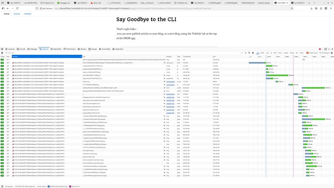

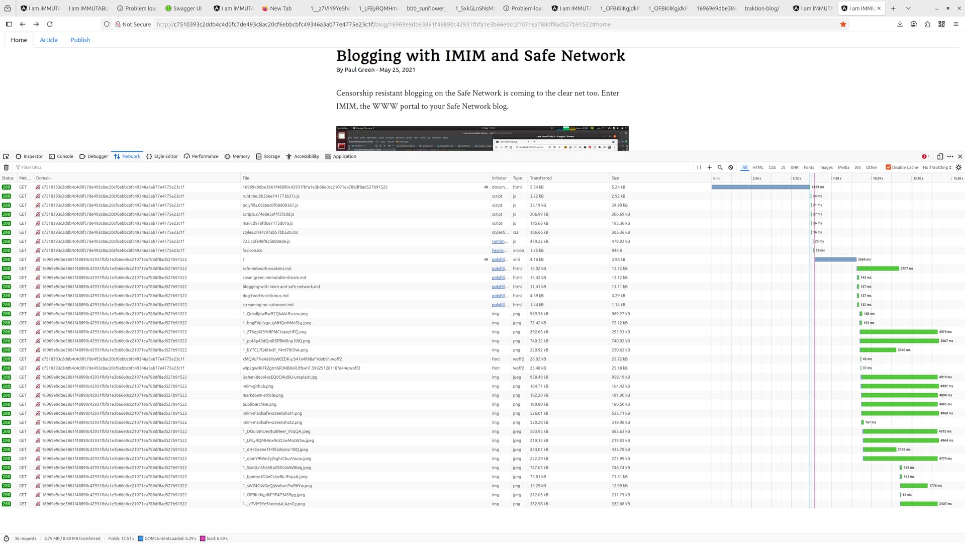

Without pointer resolution (to take them out of the equation), here is a direct comparison between public archives and tarchives for both IMIM and traktion blog (apologies for small text, but there are lots of files being loaded):
Public Archive (46 seconds from cold AntTP start with wiped immutable cache and no browser cache):
Tarchive (15 seconds from cold AntTP start with wiped immutable cache and no browser cache):
Obviously, this is worst case, as subsequent calls are either cached by the browser or AntTP. However, first loads set an impression and browsers will clear/rotate out caches. Having a solid performing base is very desirable.
I’ve very happy with a solid 3x speed improvement on a pretty comprehensive SPA (single page app). If the tar was only appended to with files grouped together for specific blog posts, I’d expect the speed to be even better, as they would all be within the same bunch of chunks.
Note that most of the images load in the background on the index and the user can use the page much more quickly.
